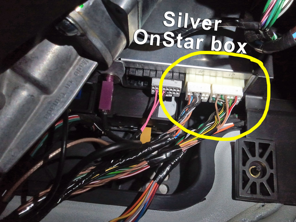

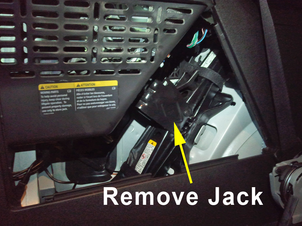

Postby williewin » June 19th, 2012, 1:36 am
I too had trouble locating the OnStar module. I was able to triangulate from several other web forums to finally find it and plug it in. Here are my suggestions:
The Onstar module is in the left rear area of the vehicle. The best way to get to it is to open the rear hatch and then locate the panel that looks like it has vents on it. The panel will have a plastic piece to push down on; this will open and you will see the tire jack. I found it easier to remove the jack.
The official name of the module is: Vehicle Communication Unit. It is a silver box located above where the jack was. I was expecting to find a box the same size as the BlueSTAR box (as seen in other YouTube videos), but it is not the same size. The one in my car did not have any writing on it except for some labels stamped into the metal named J1 and J2. It has other wires connected to it that I left connected. There are little tabs the you have to push in (on the back side of the jack) that allow you to pull the cables out. I found it was easier to use both hands - one to push in the tab while pulling with the other hand.
Just plug them into your BlueSTAR box and you should be good to go. I also added a mini USB cable to the BlueSTAR box so I can plug my laptop in to program it as needed.
Good luck!
